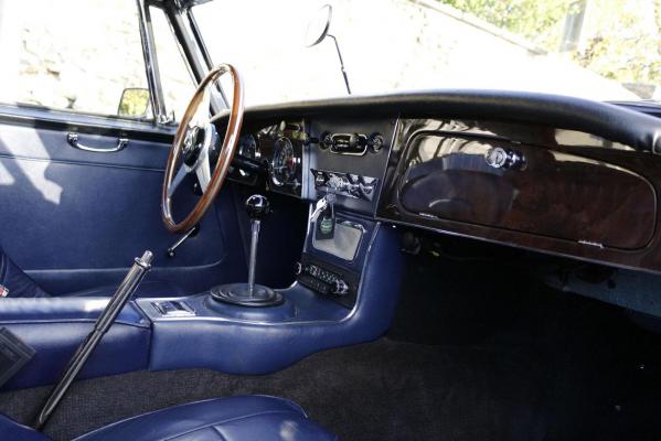

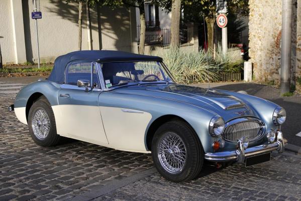

Mais place aux photos à la suite de vos nombreuses demandes.
![[Image: _mg_2811.jpg]](https://i.servimg.com/u/f62/15/69/21/46/_mg_2811.jpg)
![[Image: 976e1810.jpg]](https://i.servimg.com/u/f62/15/69/21/46/976e1810.jpg)
![[Image: _mg_2810.jpg]](https://i.servimg.com/u/f62/15/69/21/46/_mg_2810.jpg)
![[Image: img-1410.jpg]](https://i.servimg.com/u/f32/15/69/21/46/img-1410.jpg)
![[Image: unname10.jpg]](https://i.servimg.com/u/f32/15/69/21/46/unname10.jpg)
![[Image: unname11.jpg]](https://i.servimg.com/u/f32/15/69/21/46/unname11.jpg)
